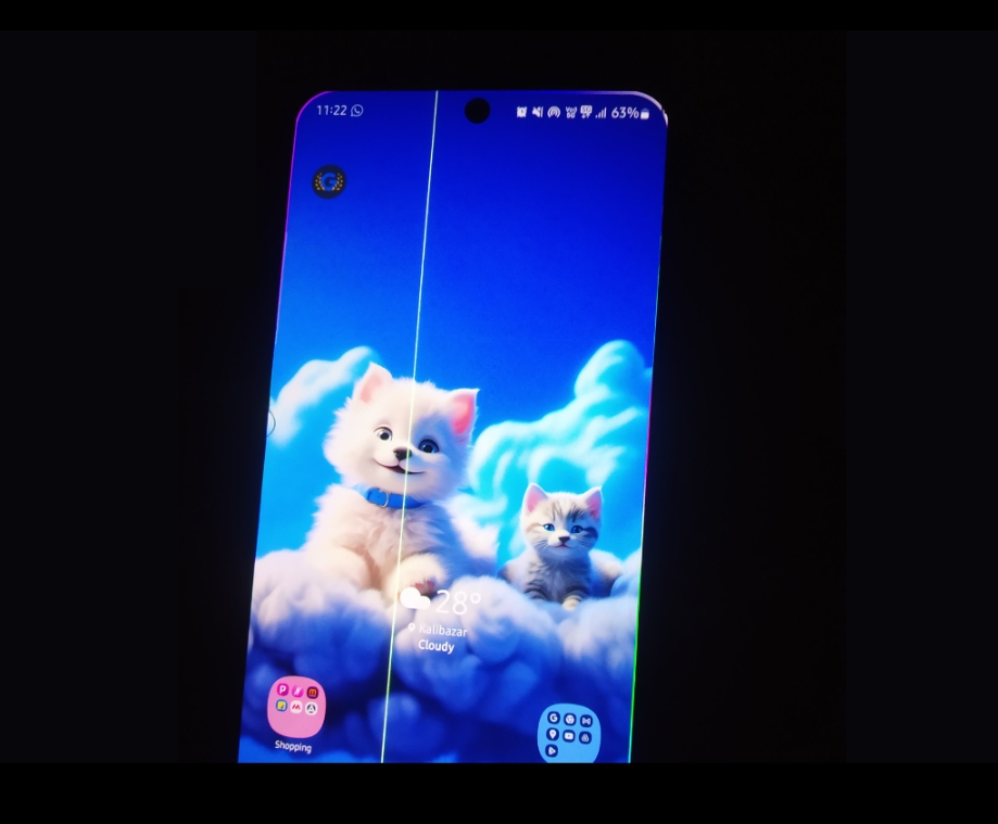

📌 What is the Green Line Issue?
A vertical green (or sometimes pink/white) line on AMOLED displays usually appears due to a hardware failure, not a software glitch. It’s caused when a row or column of pixels gets stuck in the “on” position due to a fault in the display connector, transistor, or circuit line.

🔍 Signs & Symptoms
A straight, vertical line appears — mostly green, but can also be pink or white.
Often shows up after reboot, software update, or long gaming/charging sessions.
Stays even after restarting, safe mode, or reset — confirming it’s not software-related.
