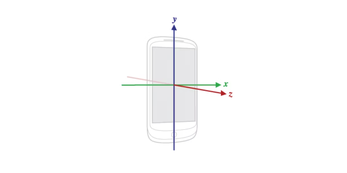

Accelerometer: As the name suggests, an accelerometer is used to detect the changes in acceleration on a smartphone. To detect these changes, the accelerometer uses the law of inertia, which states that a body at rest will stay at rest until and unless an external force is applied.
To use this concept, a fixed mass is suspended between spring-like structures in a MEMS sensor. Therefore, the fixed mass stays in place when the phone is accelerated due to its inertia compressing the springs. This spring compression generates an electrical signal telling the smartphone that it's being accelerated.
