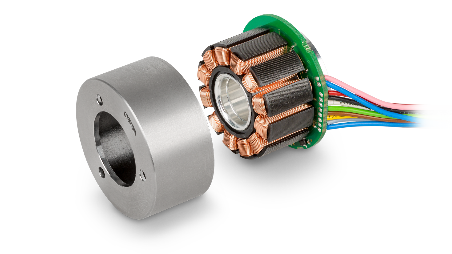

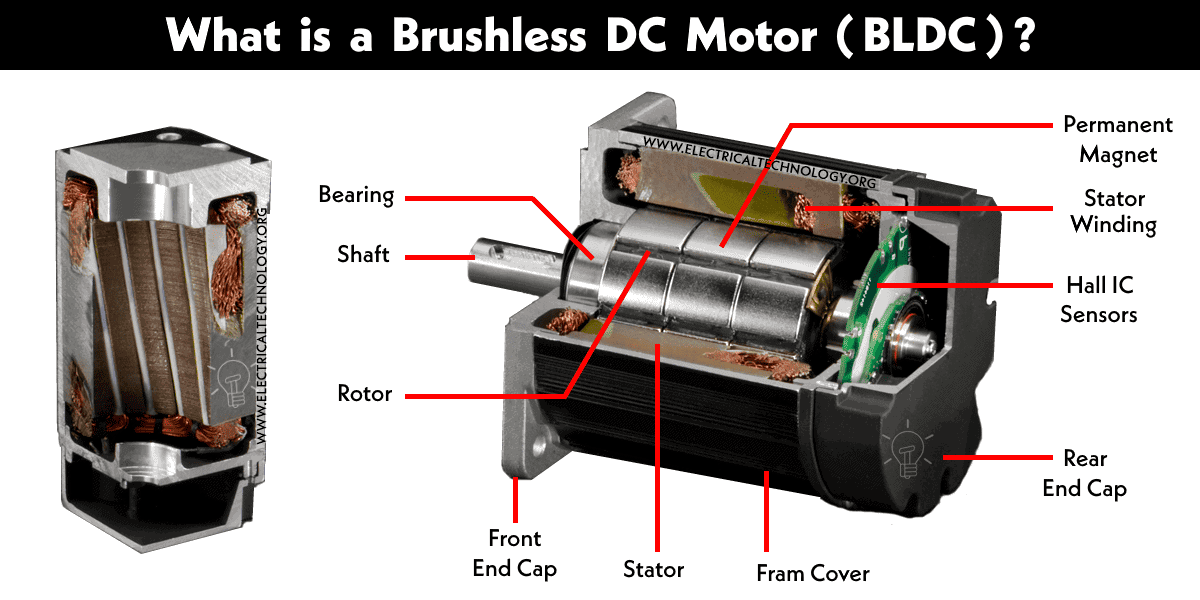

BLDC = Brushless Direct Current motor
It is a newer motor technology used in ceiling fans instead of traditional induction motors.
How it works
Traditional fans use AC induction motors
BLDC fans use a DC motor + electronic controller/inverter
Electricity from your home (AC) is converted to DC, and the controller runs the motor efficiently.
