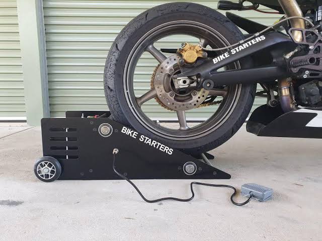

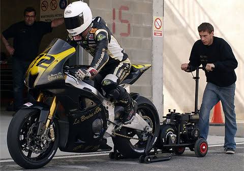

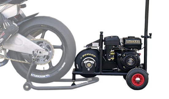

The roller starter, alternatively referred to as the paddock starter or pit starter, is an electric apparatus comprising two or more rollers positioned beneath the rear wheel of the motorcycle.
Mechanism
It operates through a battery-powered motor, activated by a foot switch, that provides the necessary power to spin the rollers. These rollers are strategically shaped to ensure the stability and positioning of the motorcycle's rear wheel.
Roller Starter
Subsequently, the rear wheel, when the clutch is engaged, sets the engine in motion. Once the engine is up and running, the clutch is disengaged, allowing the pit crew to push the motorcycle off the starter.

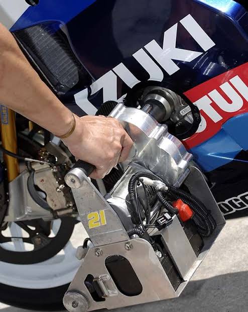

Ducati Crank Shaft Starter
The Ducati racing team employs a crank start device for initiating their bikes. This handheld tool comprises a battery-driven motorized shaft that temporarily connects to the bike's crankshaft. Functioning in a manner akin to the roller starter, this device directly applies rotational force to the crankshaft, bypassing the rear wheel of the motorcycle as in the case of the roller start device.

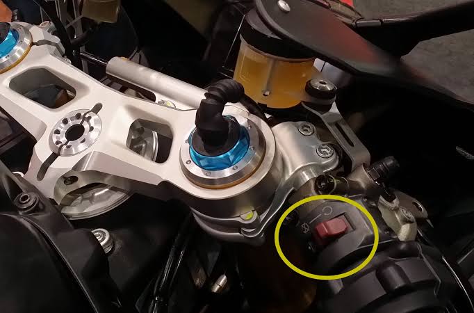

Okay now we come to know how it's starts si what about how it stops let's get into it ,the engine of a MotoGP bike can be deactivated by pressing the kill switch, typically identifiable by its red color. This switch is conveniently located on the right handlebar, well within reach of the racing driver's thumb. If this switch is inadvertently triggered while on the racing circuit, the bike will gradually come to a controlled stop, unless the driver can restart it.
Engine Kill Switch
Furthermore, the kill switch serves a safety function. It incorporates a system that automatically detects the bike's angle concerning the ground. In the event of a fall, this switch autonomously disables the ignition, fuel lines, and various electronic circuits. This automatic deactivation minimizes the risk of fire and reduces potential harm to both the rider and the track marshals who rush to provide assistance.
