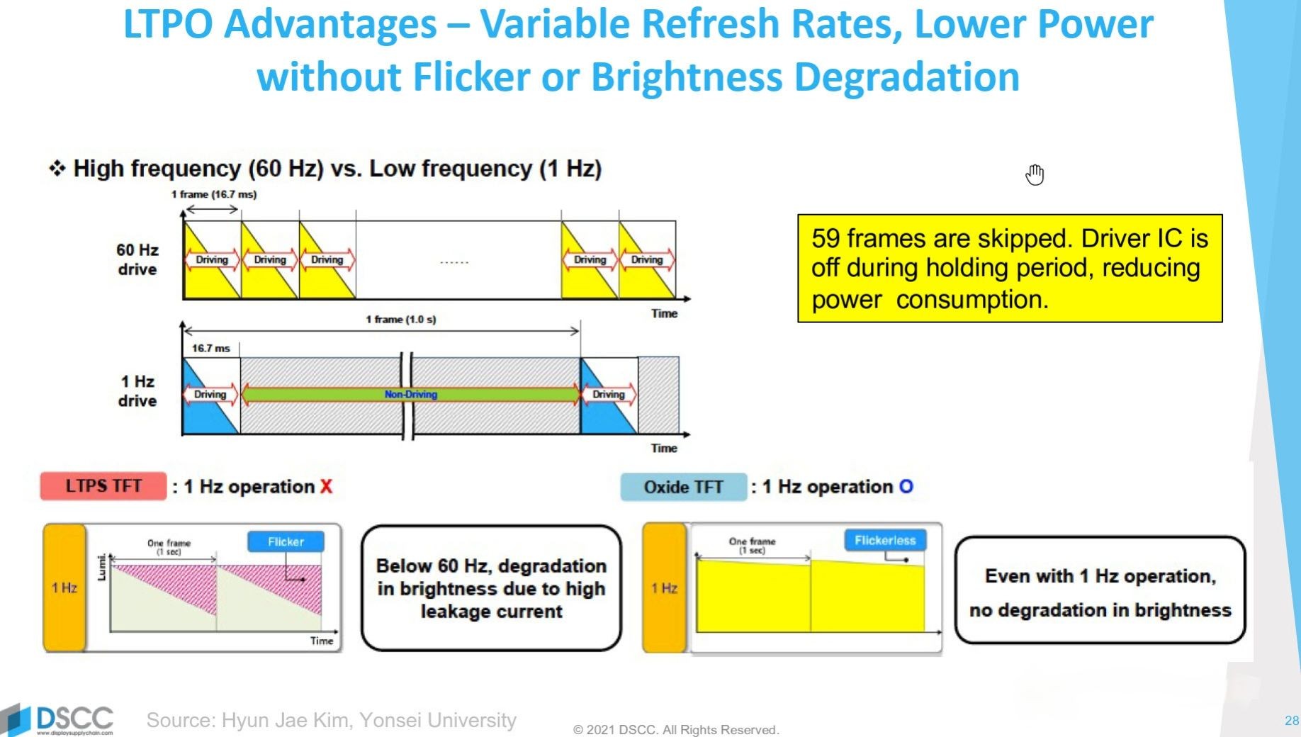

LTPO combines the best of LTPS (Low-Temperature Polycrystalline Silicon) and IGZO (Indium Gallium Zinc Oxide) backplanes. The result is a display that can dynamically change its refresh rate based on the content being viewed. This means that when you're reading an e-book or looking at a static image, the display can drop to a lower refresh rate, conserving battery life. Conversely, the refresh rate can ramp up for a smoother experience when you're watching a video or playing a game.
The Benefits of LTPO
The primary advantage of LTPO technology is its power efficiency. By varying the refresh rate, LTPO displays use less power than traditional OLED screens, which are already more energy-efficient than their LCD counterparts. This is particularly beneficial for wearable technology, where an always-on display feature can be provided without significantly impacting battery life.

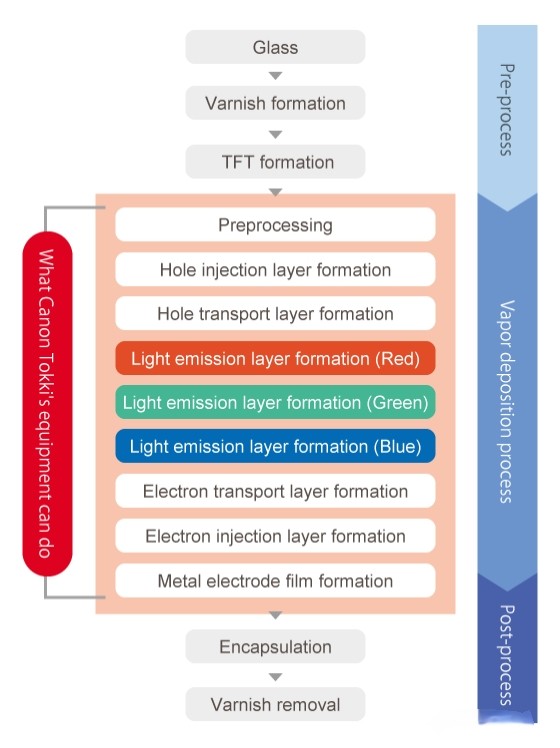

The advent of LTPO technology has revolutionized the OLED display market. This section delves into the intricate manufacturing process that enables LTPO OLED displays to offer superior power efficiency and dynamic refresh rates. LTPO technology combines LTPS TFTs (Thin Film Transistors) and Oxide TFTs (IGZO) to create a backplane capable of adjusting the display's refresh rate dynamically. This adaptability allows for significant power savings, making LTPO OLED displays ideal for high-end electronic devices.
Courtesy:- tokki.cannon
Step-by-Step Manufacturing Process
  1. Substrate Preparation: The process begins with preparing the substrate, typically glass or a flexible material for bendable displays.
  2. TFT Fabrication: Next, the TFTs are formed on the substrate. In LTPO displays, this involves creating a combination of LTPS TFTs for the switching circuits and IGZO TFTs for the driving transistors.
  3. OLED Layer Deposition: Following TFT fabrication, the OLED layers are deposited. This includes the application of hole injection, transport, and blocking layers, followed by the emissive material.
  4. Encapsulation: To protect the OLED layers from environmental factors like moisture and oxygen, the display is encapsulated with a thin film.
  5. Testing and Calibration: The final steps involve testing the display for quality assurance and calibrating it to ensure accurate color reproduction and uniform brightness.
