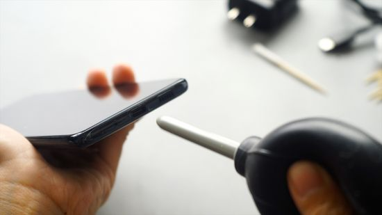

1. Compressed air canister

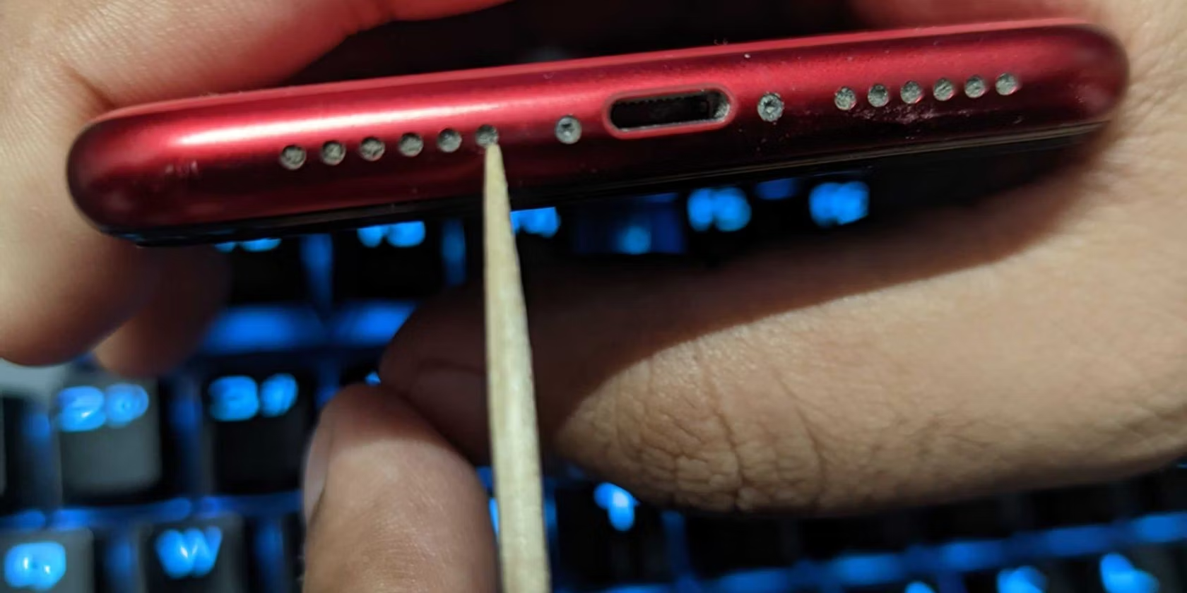

2. Toothpick or SIM ejector tool
3. Soft-bristle brush
4. Isopropyl alcohol (90% or higher)
Steps:
1. Turn Off Your Phone: Always turn off your device before cleaning.
2. Blow Out Debris: Use a compressed air canister to blow into the USB port to remove loose dirt. Hold the phone upright to allow gravity to assist in the process.
3. Gently Scrape with a Toothpick or SIM Tool: Use a non-metal tool like a wooden or plastic toothpick to gently scrape out lint or debris. Avoid using metal objects like pins, as they can damage the port.
4. Brush the Area: Use a soft-bristle brush to sweep away any remaining particles.

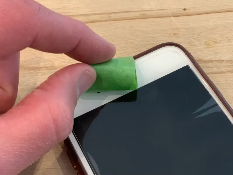

3. Adhesive putty
Steps:
1. Turn Off Your Phone: To prevent any accidental damage.
2. Brush Gently: Use a soft-bristled brush to gently sweep over the earpiece mesh. Ensure you're not pressing too hard, as this could push dirt further into the grill.
3. Compressed Air: Use short bursts of compressed air to blow out debris. Do this from an angle to avoid forcing dirt deeper inside.
4. Adhesive Putty: Roll a small piece of adhesive putty and lightly press it onto the earpiece grill. It will help lift out dirt and dust without causing damage.

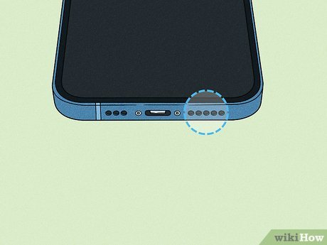

3. Cleaning the Speaker Grills
Why It's Important:
Speaker grills can get blocked by dirt and debris, leading to muffled or distorted sound. Keeping them clean ensures optimal audio quality during media playback and calls.
Manual Cleaning Method:
Tools Needed:
1. Soft brush
2. Adhesive putty
3. Compressed air
4. Microfiber cloth
Steps:
1. Turn Off Your Phone: Safety first to avoid damage.
2. Brush the Grills: Use a soft-bristled brush to clean around the speaker grills. Be gentle, as the mesh can be fragile.
3. Use Compressed Air: Blow compressed air lightly over the speaker grills to dislodge any lodged particles.
4. Adhesive Putty: Similar to the earpiece method, adhesive putty works well for speaker grills. Lightly press the putty onto the grill to pick up dirt, then peel it away. Repeat as necessary.
5. Wipe the Area: Finally, use a microfiber cloth to wipe the surface, ensuring there's no leftover dust.
