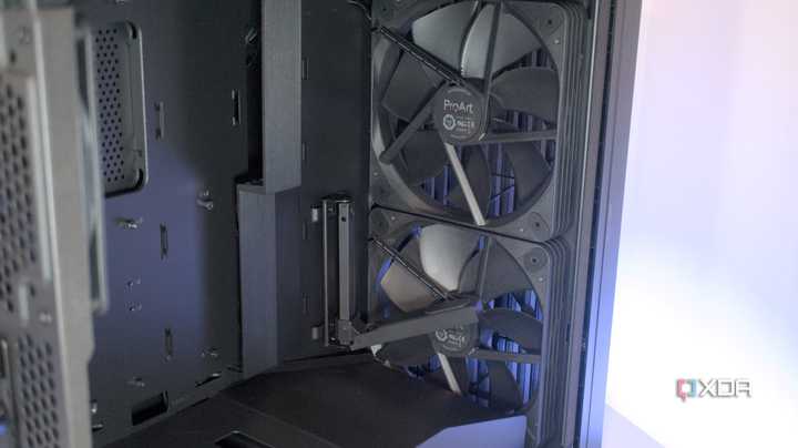

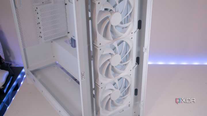

1) The more fans the better
It sounds wise on the surface — the more fans you install, the more air you can get inside your PC. However, what matters more than the number of fans is the fan placement.
Simply filling up all the fan slots inside the PC will not bring down your system temps by itself. You also need to keep positive pressure in mind and avoid turbulent air from disrupting optimal cooling inside the case.
A case with positive pressure means you have more air coming into the system than going out of the system. This is usually achieved by installing more intake fans than exhaust fans, with most users relying on 2 to 3 fans for intake, and 1 to 2 for exhaust.
Avoiding turbulent air means you're not installing fans in a way that results in conflicting airflow — the intake and exhaust fans should work in synergy to create a seamless airflow path.
Lastly, the type of case fans matter much more than the number of fans

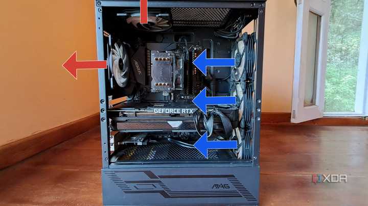

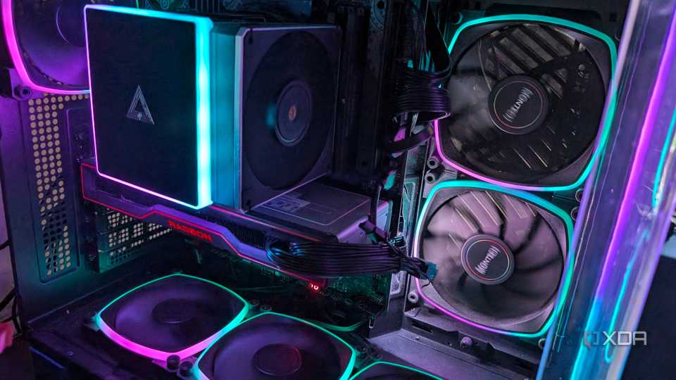

4) Fan configuration doesn't matter if you have enough airflow
This is yet another myth that could be keeping your CPU temperature unnecessarily high. Despite enough air coming into the case, you could end up with sub-par cooling if the case fans aren't positioned right. Optimal fan configuration is crucial to creating unobstructed airflow inside the case.
Your intake and exhaust fans should be installed in such a way that they work together, not against each other

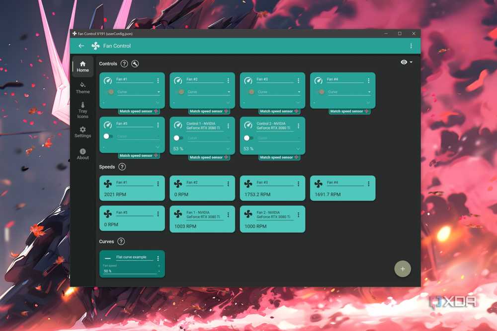

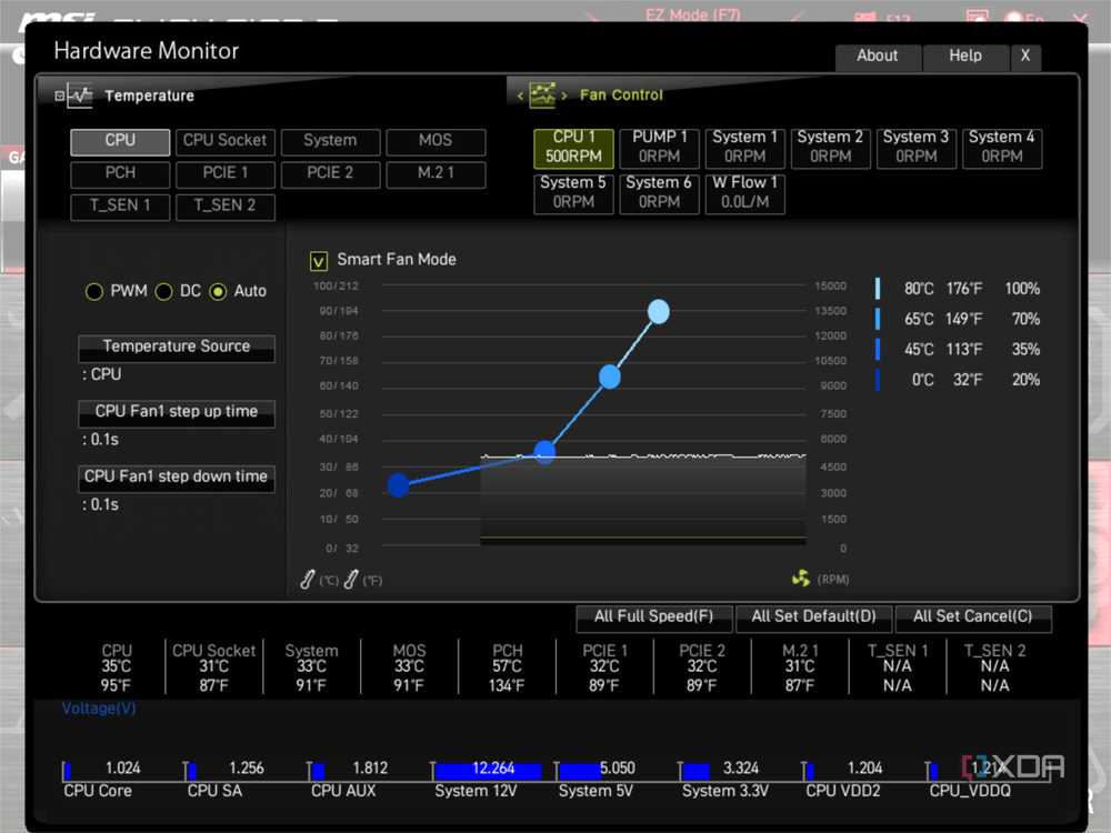

5) Default fan curves are good enough
The default fan curves in the BIOS/UEFI or even in motherboard software aren't always the best.
You can find silent, standard, and performance modes in these programs, but they simply can't replicate the optimum curves for every PC out there
This is why tools like Fan Control are so powerful — you can not only set individual fan curves for every fan but also set them to function together based on various parameters.
