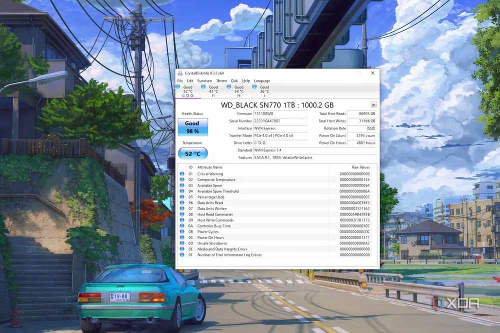

Calculate your SSD's remaining life using CrystalDiskInfo
CrystalDiskInfo is a free utility that shows you detailed information about your storage drives, including drive health (Good, Caution, Bad, etc.), and more importantly,
Total Host Writes, which tells you how much data has been written to the SSD till date. Comparing this number to your SSD's TBW rating, you can estimate how many years of flawless operation your SSD has left.
Divide the Total Host Writes figure by the "TBW x 1000" number to get an idea of how much of your SSD's lifespan you've used up.
For instance, the Total Host Writes number for my WD Black SN770 is 31566 GB, and its TBW is 600. Dividing 31566 by 600,000 (600*1000) gives me 0.052, meaning I'm only 5.2% into the SSD's lifespan.
