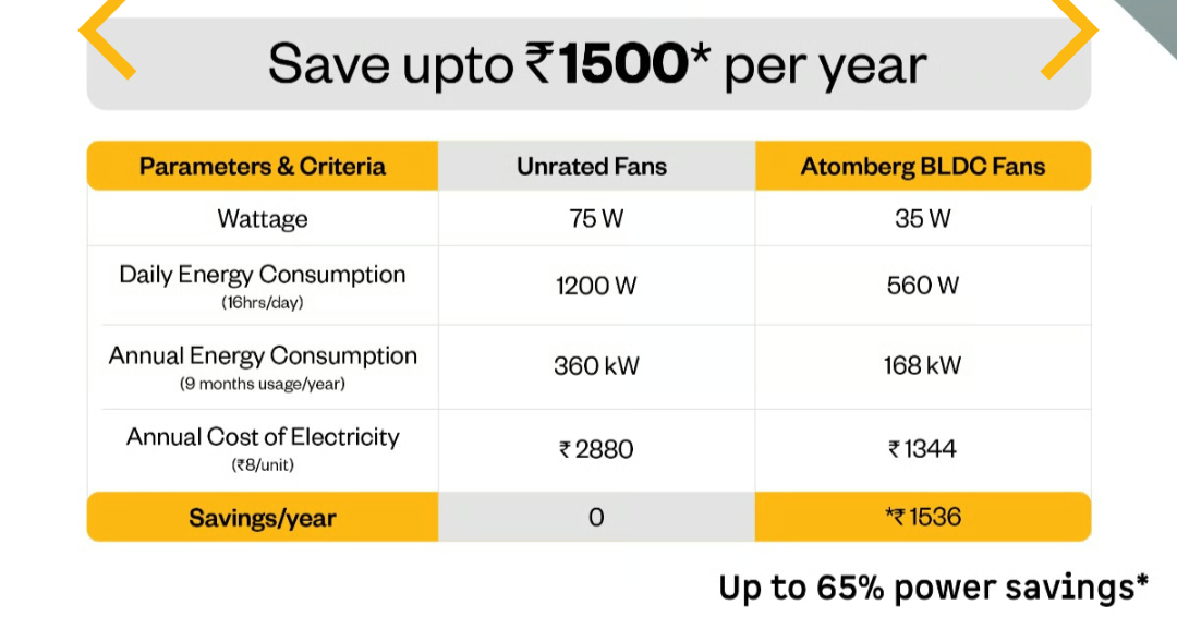

If you use your fan only for 2–3 hours a day, an AC motor fan is perfectly fine. But if your fan runs for long hours (which is the case for most people), a BLDC fan is usually the better option because of power savings.Here's a chart for reference.Check if this suits you and decide accordingly.

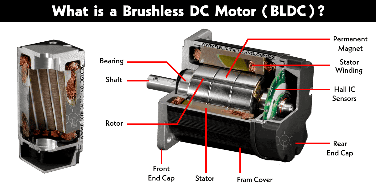

1. Confirm it has a BLDC motor
This is the first and most important thing if your goal is energy efficiency.

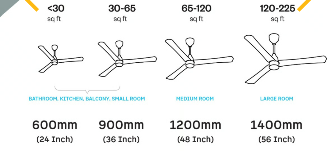

14. Sweep size
A fan's sweep size should be accordingly with you room's area.Here's a chart for your reference:
